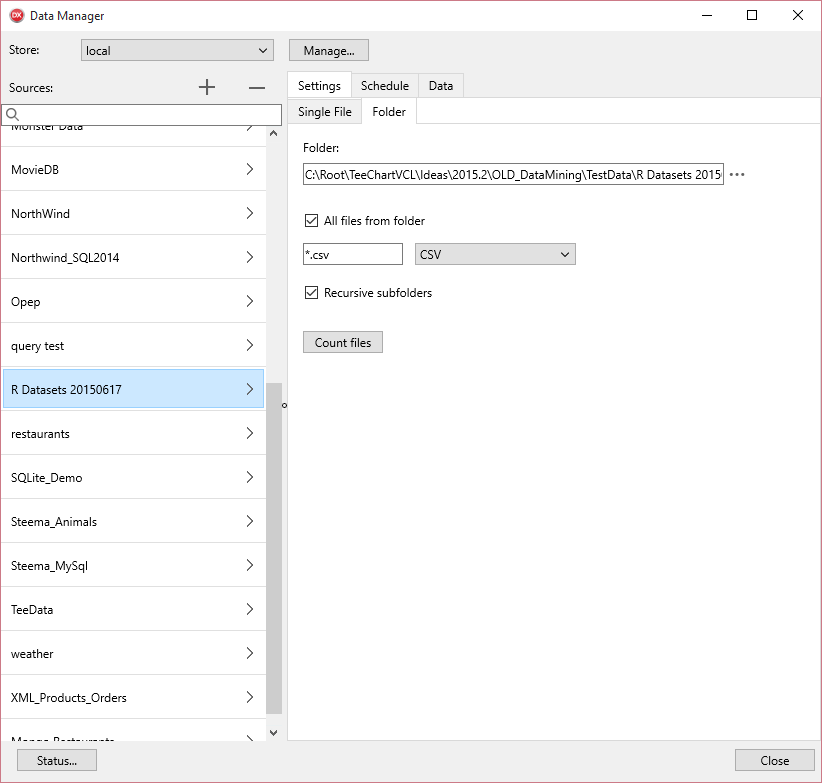

The "Data Manager" editor dialog, usable at design-time and run-time, allows adding/removing data items and configuring them to import and persist the data.

The Data Manager dialog (and all other dialogs) are available for both VCL and Firemonkey frameworks:
Different sources can be configured in the Data Manager, like:
  • Text files (CSV, JSON, XML) from a folder or an URL.
  • Microsoft Excel spreadsheets
  • Database connections (using FireDAC, SQLExpress or other libraries)
  • Data that is in another BIWeb server
  • Contents from compressed *.zip files
